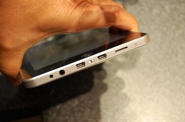

Hi Tipstir,
No it is not my tablet. Mine is the one pictured below :
Updated info :
I purchased my "Rockchip 7" Apad" tablet on eBay in July. When I received it ran correctely some days but it regularly crashed when watching a film or during a web session. Of course it was totally charged around 4 or 5 hours.
My device is "probably" the Apad batch 2 : red led, camera, plastic back, 5V charger. No sticker or branding on the back.
I tried to flash it with HiApad website update.img files.
Not easy, many try but got a decent boot after some try
But always the same : the tablet ALWAYS crash some minutes after boot.
Yesterday, I tried to flash it with custom firmwares.
Bad idea ...
The flash process seem successfull byt my tablet don't boot anymore.
I had the usual restart process :
- recovering sytem
- formatting data...
- Formatting cache...
etc...
and I arrived on a screen like this :
+ xaueious firmware branding near iRobot
... and nothing more. It is blocked at this status.
So I switched off after waiting around 10 or 15 minutes and tried again to boot.
Always the same.
The bad new is that it seems that the flashing tool does not recognize my tablet now.
The very bad new is that it seems that I cannot format device thru windows XP to try to start again.
I have a doubt : is it a software problem (flash version) or is it a hardware problem ? My device ALWAYS crashed after some minutes of use. It could be this reason if I cannot boot normally, as boot after flash is always long.
I am desperate. Any help welcome
Regards
Philippe
Are you sure you flashed the correctonefor your device? My ROM batch 2 only, and it works great on batch 2 devices.
As the result I have, of course not :-/
BTW, there is written HybridKangXau 1.3 by xaueious and every thing let me think that I have a batch 2 ....
An other info :
When trying to boot the device, I see the internal two disks as E: and F: on my computer. I tried to format them in FAT32 but the computer answered "there is no disc in this unit" both.
At this time the RKAndroidDM 1.2 see the device (without pushing on the home button) but if I try to flash it with an update.img file it says quickly "switch to rock usb failed, please re-plug device"
