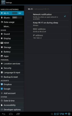

You should have keep WiFi on always under advance options, could be a ROM issue, I have no idea if you are running ICS or jb or if you are running either mine or MCL ROM but that option to keep WiFi on always should be available $uploadfromtaptalk1359338277483.jpg
Mine looks similar to that EXCEPT the Keep Wi-Fi on during sleep item is missing. I am running stock ICS out of the box and don't want to mess with that till my 14 day return period is up in 8 more days. BTW, I don't have a HDMI item under Device.

I'm installing the OTA JB update now... maybe that will fix it.
Yeah probably the ROM's problem since we all have the WI-FI setting but you. OTA JB update should fix the problem. Hope everything works again for you after the update :)
Thanks, I'll post back later with the result.
Just finished the OTA JB update and now I do have the same settings screen as shown above. Now I have a bunch of apps updating so I'll see how the wifi behaves after that.
The JB update went well and the wifi issue appears to be resolved without even using the never sleep feature. Thanks to all for your help. Seeing that screen shot showed me that I needed to do the upgrade.
