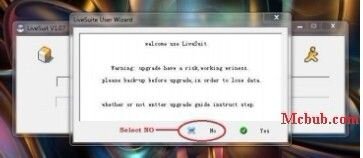

Follow the steps below to carry out the Novo 7 firmware update procedure…Launch the LiveSuit application

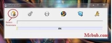

Browse firmware file by clicking the icon below

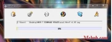

Select the downloaded and extracted Novo 7 firmware .img file

When the steps above have been carried out correctly, the following window below will be displayed...
At this point you MUST release both buttons or the device will switch off.
