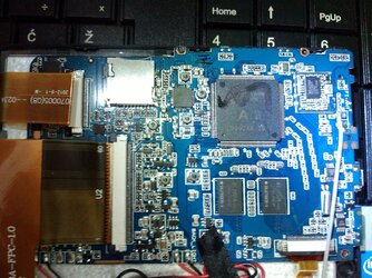

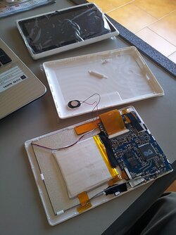

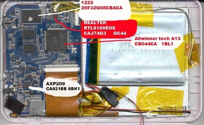

Requires ROM or Firmware for Tablet 7 "Allwinner tech A13 Q8V07 25.09.2012.'ve Tried more than 30 roms.

I have two tablets but one recently bricked. I tested many others roms, but neither worked.
The "A13 goodix811 with mxc622x" Rom worked with touchscreen horizontal inverted, no camera, no wifi.
Look this ROM list: http://inside4ndroid.moonfruit.com/#/a13-ab-downloads/4570792769
If i learn to "clone" other tablet rom, se are saved.
Do you know to do it? Any suggestion?
Sorry, my english is not avanced.
Inside Components:
NAND FLASH MEMORY
Hynix h27ubg8t2btr
PROCESSOR
Allwinner Tech A13 C8081BA 29H1
RAM
Nanya NT5CC256M8GN-CG x 2
WIFI
Realtek RTL8188EU
POWER MANAGER
AXP209
TOUCHSCREEN MANAGER
GSL1680

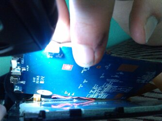

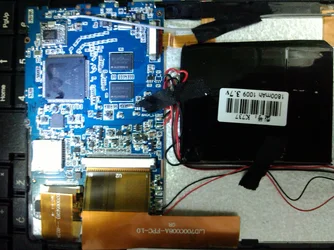

I got the "clone" rom as mensioned, but didn't work. Then i opened the other tablet and descovered different motherboard. Little differences, but importants.
As desesperate, i tried do test more roms, and........... i found the perfect ROM!!! Ok, is has just a little thing, the camera didn't work.
http://www.ele-china.com/soft/tablet/7inchA13/201210/Q8-mxc622x-20121101.img
Test this ROM and tell me about.
If is not really good, try something like Q8 mxc622x variants.
And if you found better ROM, tell me.

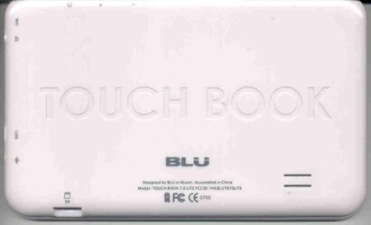

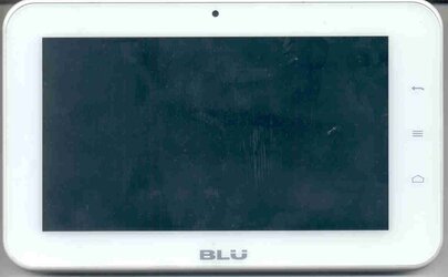

Hola buenas noches a todos,helshing33,tengo una tablet que dice ser blu touchbook 7.0 lite,la cual le metieron mano y le instalaron una rom que tiene el touch invertido y la camara no le funciona,no se si seria posible que tuvieras la rom correspondiente o me orientaras sobre con que nombre puedo buscarla,esta es la tablet en cuestion.
llevo mas de una semana buscando bajando y probando roms pero ninguna le queda,de antemano agradesco tu atencion. mi correo es [email protected]
De nuevo muchas gracias.saludos desde ciudad juarez chihuahua mexico.
Alguno ya conseguió la perfecta rom para Blu Touch Lite 7.0??? Consegui esta que funciona todo, solamente no funciona la rotación y la parte donde esta el volumen de tablet no funciona derecho pero puedese usar las funciones del touch: rom a13 30725 - Download - 4shared puebrala, se alguén tenga una rom mejor ponga el enlace aca para ayudarnos a resolver ese problema. Gracias a todos.
