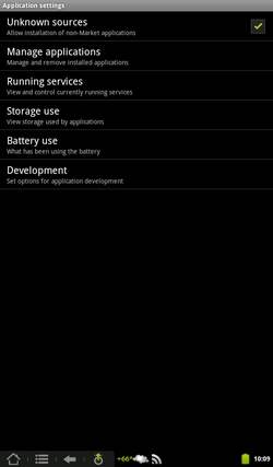

Welcome to the forum. I apologize for the rudeness you've received. When you open your app drawer and tap on Settings and then Applications, you don't see this? (Click on it to make it larger)
I am working on B&N 1.3. Okay Manual Nooter 4.6.16 I am not booting from a SD card - does that give you some more info. I really want to get this Nook fixed right if someone is willing to help me. I am sorry I do not know any more than I do but I am trying.
