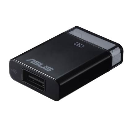

The USB cable included only offers USB Slave support. That means that it can be used to access the TF300 as a device on a device with a USB Host port (like a PC).
You need to get either the Keyboard dock or the USB adapter kit from Asus that gives you a USB Host port.
Let me find a link for it.

Using the adapter Frederuco point out would work, your female - female solution won't. Your other option is to get the keyboard dock. That would also let you use a card reader. But you get a standard SD card reader with the dock as well.
