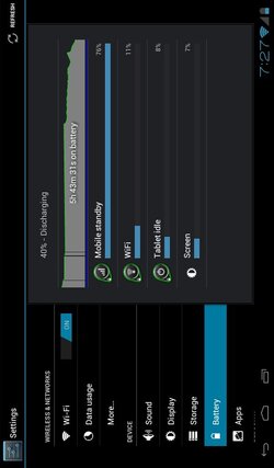

I have now downloaded a free airplane mode app, enabled it & then turned wifi back on. After doing this my battery stats still show around 70% used by 'mobile standby' which is strange.

@criver It could be a faulty airplane mode app although when I switch it on it does correctly disable wifi which I then have to re-enable. ICS battery stats shows 'mobile standby' see attached.
