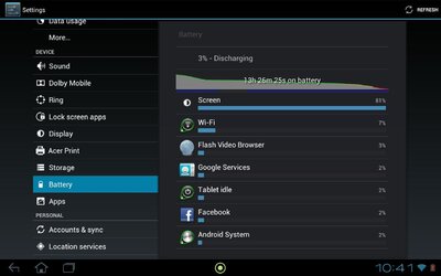

this is from one day last week. I did a ton with it that day... I have virus scan off and I tend to run at minimum brightness indoors. Since the screen shot, I added rootdim to get the screen even dimmer.

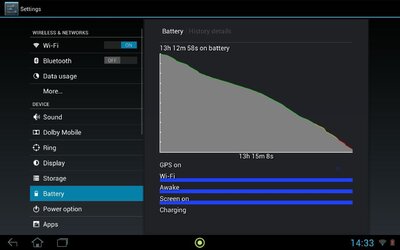

My battery discharging from 100% to 3% non stop -> with GPSon, WIFIon, displai 65%, browsing internet, play games, download a loot wallpapers, instal and deliting program and play music...!!! There'is sam's pruf with image...! :)
