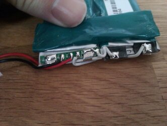

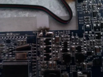

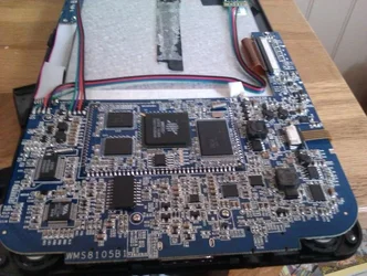

I opened the device to check the wires but can't find something strange (see photos). What's the problem?

Check the solder joints at each end of the wires going to the battery. Use a multimeter to check for continuity and voltage.
A new battery won't fix the problem if the soldering job is bad on the leads. I would check that first before spending money on the battery....
Ok i gonna do that, the wires on the battery looks good to me (see photo) I will check the rest of the wiring. And I will look if can borrow a multimeter.
