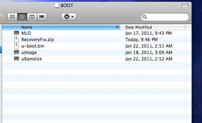

Ok. I was trying to install a Rom with the wrong recovery and it didn't work. I was then going to restore a backup in CWR and wanted to make sure everything was clean so I started with "format boot" it froze and I lost recovery.
Now I believe I have a Nook with nothing on internal memory and no recovery.
I burned a cwr image as per Vic's post but I used a Mac instead to burn an image. When I instert the bootable sdcard there is no response when I try to turn the nook on with any type of button combos.
I have attached pictures. Can you tell me if the files on the bootable sdcard look correct or is there something missing? Is my battery just dead?

I did the samething. Do you have acess to windows machine? I did the boot repartition file from samuelhaff over at XDA. It worked i was able ti get back to a nandroid.
I think you are right about the boot image issue.
There is a good chance it is a dead battery. Depending on how much you were playing with CWR you can use a lot of juice. One other thing you might try besides just charging is plugging into the USB sometimes hooking up to the computer helps bump start the booting.

I found samuelhaff's guide. I may try burning nookie froyo to an sdcard and try booting from that. I do not know why my bootable CWR card isn't booting.
I cannot find the link now. It came from samuelhaff i am sure of it. BSOD is what isearched but now i cannot find it. Search XDA lots of people have done it. Sorry i could not find the link.
I think I found the xda link. My battery could just be dead. If it doesn't boot after charge for a while I am going to try that method. I can burn nookie froyo on a Mac to an sdcard and see if that boots I guess.
*Edit: or I did something wrong when making the bootable sdcard. I have the exact instructions for nookie froyo via Mac to sdcard, so I will try that.

I should have never formatted boot as it usually gets rid of recovery. But if it doesn't freeze like it did to me one can just back up to main recovery menu after. I wanted to format boot and system to ensure the device was absolutley clean before restoring a backup. But really all that is needed is wiping data and cache. I will never format boot or system again.
I think I typed the dd commands in wrong when making a bootable cwr sdcard on the Mac. I am going to try making the nookie froyo bootable card since I have the exact dd code for that and sdcard image for that.

I tried to backup my system from ROM Manager instead of backing out to Clockwork and my NC would only boot into recovery, I tried all my restores and tried to install every ROM I could download from zip and nothing. I could boot nookie froyo from sd.
I believe this is the thread I used, I guess it messed up the EMMC memory and that had to be repartitioned/rebuilt, I did this and was back up and running in to time.
[RECOVERY][ZIP] Nook Color Restore to stock - xda-developers
Thanks for the help everyone. It is still not booting from my bootable nookie froyo sdcard I made on the Mac. I am going to try to burn the img using a pc when it is available to me tomorrow night.
