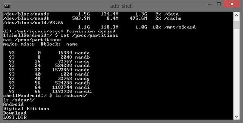

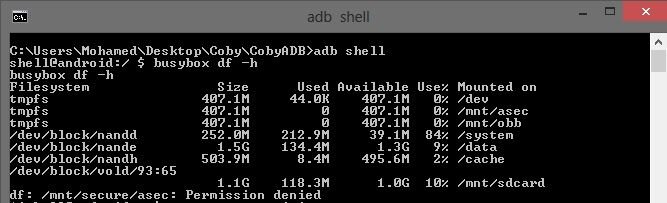

mount the sdcard in cwm
adb shell
busybox df -h
post output
cat /proc/partitions
post output
ls /sdcard/
post output
Here are the outputs:
You are right. My bad :D
