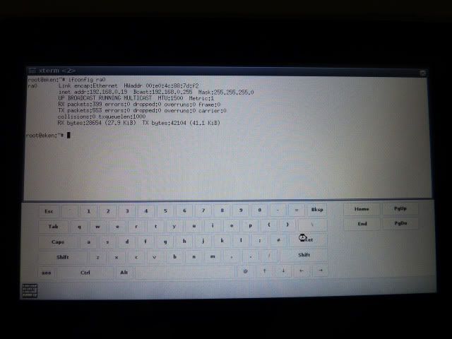

- Wifi works 100% all you have to do is run the built in config utility.

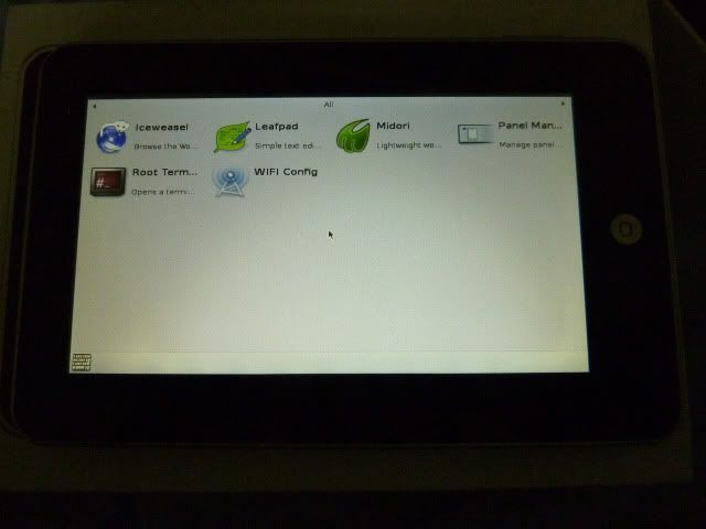

How does it look?
Here's some screens of my flytouch with matchbox desktop manager running with debian (no video this time until i get my english better or leave college to get some more extra time, whatever happens the first):
