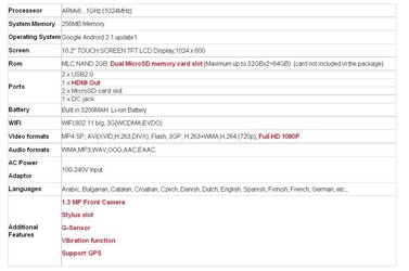

recently i bought below device with below configurations .I want tp upgrade my Uprating system Google Android 2.2 .I spend lot of on the net to find the way for this firmware . i learned how to flsh and all .But , unfortunately i am not able to find the firmware file .Kindly support really appreciated your time and support .
10" GPS Google Android 2.1 HDMI WiFi Tablet aPad 1GHz
Brand : Zenithink ZT-180
Processor Speed : 1,000 MHz
Processor : ARMv6 , 1GHz (1024MHz)
Memory (RAM) : 256 MB
Operating System : Google Android 2.1 update1
ROM : LC NAND 2GB. Dual MicroSD memory card slot
More info as screen shot
Thanks in advance
