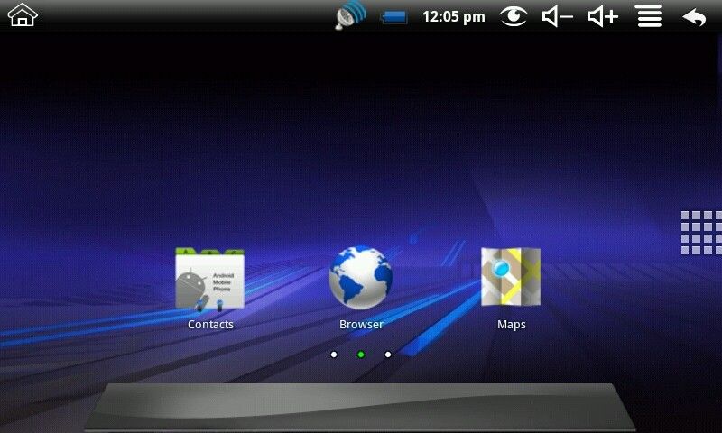

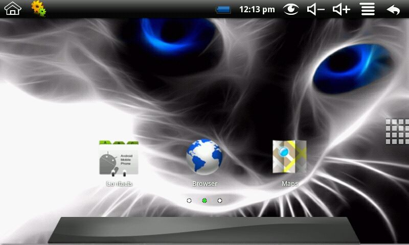

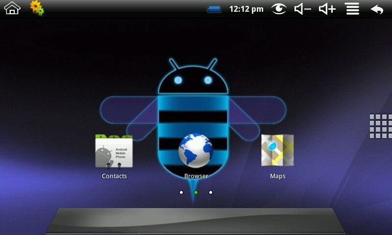

Slider Lock Screen with Wallpaper Gallery Slideshow
Home Screen
Dock Box Launcher (Upgraded)
