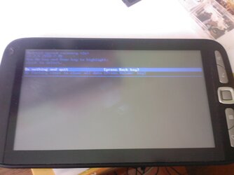

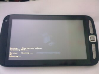

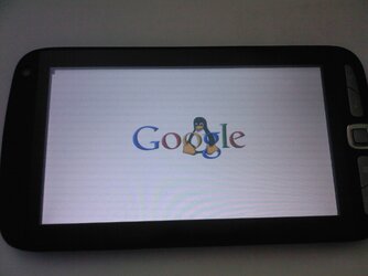

When I enter the service mode screen orientation is normal! In this mode, I can perform a factory reset or do re-flash. Below I show the photo.
comment..
Pressing the key combination to enter the service mode I have the Google logo, then there is the service menu or the status of flashing (depending on the keystrokes when the turn), and depending on the selected menu item, reboot. All this in a normal orientation of the display. There is a caveat, no reboot is performed independently. The device hangs on the label "reboot" and I have to press the "reset".
And then, as it was before, snowman upside down in a mirror image. nothing else happens. MID does not boot - hangs.
