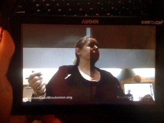

I am also having this same problem. I called Augen and they said and update for the factory reset / clearing of private data would be available on Thursday. I bought mine and it has a defective screen, and I can't return it until I clear the private data and I cannot. I hope this fix does indeed come out on Thursday because I am anxious to return this and swap it for one with a good screen.
What's wrong with the screen? Dead pixels or stuck pixels or the screen is washed out showing more grey?
It's strange. There is a line down the center and the right side of that line is darker. At first I thought it was a graphical effect because it only shows up on darker colors, so i thought it was a sort-of theme thing. But when I went to view photos and videos I realized, oh crap, it's a defect. You can't see this division line on white or light colors, so that's why I thought it was an effect at first.
