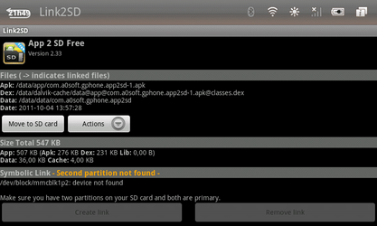

Hello
Thanks all for your´s colaboration and all help given.
In fact I´m in a "circle" of the same problem. After partition´s format with success the tablet don´t recognise the SD card when I install in it, neither the Links2SD. Send´s me all the time to Format the SD card. Since I format with this way, Link2sd dont recognize it. So, I can keep here for ages that I wont find the solution.
I was trying to find an older version of Link2sd but I couldn´t. Manxman, thanks for the tutorial and I´ve sent an pm for you.
I attached in this message a print screen of an image in Link2SD to see the error messages that is giving me. One thing that I think curious is that the Link2SD tell´s me that the "second partition is not found"! I´ve all the time conserved this partition, I think when tablet format SD card partition do that in the first one because all the time the SD card keep´s the 1st partition with 5Gb and the second partition with 2GB. Maybe if you see you can find some more than what i found!
Tom, thanks again for your help, very helpfull.
Meanwhile I´ll try this way with this last suggestion; because in fact I think the tablet it worth 100% with all this well configured.
Best regards
pedro
