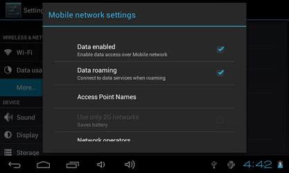

I Assume that your tablet is running on Android ICS.... Now, Check the following settings:
1. Open settings >> Wireless & Networks >> More..
2. In that open "Mobile networks" option
3. Check if the options DATA ENABLED and DATA roaming options are selected... now insert device and wait for few seconds.. Hope it'll be connected..

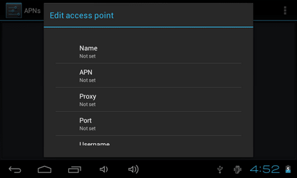

If it does'nt connect do this:
1. Connect your dongle..
2. open Access Point Names from the above said menu..
3. from the option select NEW APN and fill it with your internet settings(especially APN) provided by your service provider and save..

Joy Thakur!Thanks a lot for so quick reply. I have tried what have you sugested. yes the Byond MI3 is with ICS and am using aircel PI. I've put MCC as 405, & 801 as MNC also, but the tablet did not save the APN config. & can't find dongle though. I've tried with Vodafone Stick too! Please Help!!!

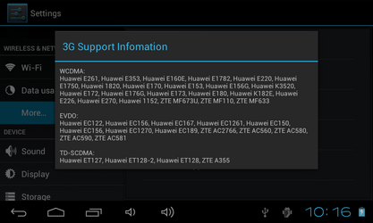

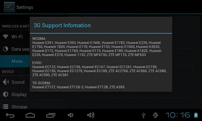

To check that ur dongle is supported or not::
>>>>>> In the same menu above check if there is an option called '3G support Information'... In that check if your Dongle model is listed or not... If it is not listed then your dongle may not be supported...
Other than this i am not getting any other causes for ur problem.... :confused:
Thanks again. Yes the dongle not supported.... but how on earth it was running perfect on the first day and night!! I'll purchase one Reliance dongle and wait for the best. Thanks again... Joy Thakur!
