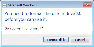

Ok what does it mean if once you connected you USB, it tells you that you unknown file systems, and asks you to format it

Ok I got pass the format. It appears I blew away the whole android OS - all I have is clock work installed. (thankfully) Question now is how the heck do I get a replacement
