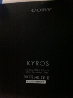

omg...i have CK Mid9742,installed ur Mobiz V2 then the 9742 boot.img...
then added some btusb ko's....then pulled dump...hmm, how is it possible to show novo?
i'll be posting some pics later or tom for the tablet settings...
EDIT: here's my "About Tablet" seciton
Novo?!?
