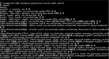

Ok, using mount in shell I get a large list, wich includes:
As you can see, at the beginning, it points to three folders in /dev/block/, apparently hidden:
/dev/block/mmcblk0p2 /system ext4 ro,relatime,barrier=1,data=ordered 0 0
/dev/block/mmcblk0p5 /data ext4 rw,nosuid,nodev,relatime,barrier=1,data=ordered 0 0
/dev/block/mmcblk0p6 /cache ext4 rw,nosuid,nodev,relatime,barrier=1,data=ordered 0 0
So.. There's no BACKUP option at all, I guess I'm stuck again :confused:
