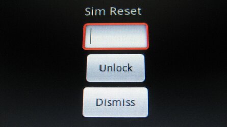

I get a "Sim Reset" when turning on my S7 tablet. It has nothing to do with the sim card I am using so far as I can tell. It seems I have been 'locked' out of the tablet. Here in OZ Telstra sells it as a T-Touch Tab. Telstra could not help me after spending 3 hours on the phone today with 4 different technicians in the Philippines.
The wifi works fine and so does everything else, but it will not accept / recognize my sim card, ergo - no 3G.
Can someone help?
Thanks
My understanding is that the T-Tab is locked to Telstra and you need an unlock code if you put in another sim. Maybe it has do a sim reset from too many tries or something? not sure.
Tried another sim card. Same thing.... both sims work elsewhere. Both sims active. I have spoken to Telstra support..... they're at a blank. (No surprises there!) Here's a picture of what it looks like.... And I am sure it has NOTHING to do with the Telstra Sim itself. I believe it is some kind of 'lock out' after too many tries with different sims.... maybe! anyway, it's there all the time and nobody knows what it is... some one on this forum will....! :) $IMG_0121.JPG

That message is because the phone is locked. You need the unlock code. Someone in Telstra that has clue will give you a code for a fee. You will not get that message with a telstra sim.

First I would make sure that you still get the problem with a brand new Telstra pre-paid broadband SIM, or a Telstra post-paid SIM with data enabled. If you still get the same message, then it is a tablet fault. Claim it under the 1 year warrantee. Go into the Telstra shop, be insistive that they return it. Refuse the leave the store until you are satisfied that it will be replaced. If you get no luck, then you always have the small claims tribunal to threaten them with.
LATEST and Case Closed:
Thanks to all of you for your help and suggestions. Thanks especially to you pvella for your efforts.
Today I called Huawei in Melbourne, VIC Australia. Spoke to an AWESOME technician there called Andrew Wang. As I explained the problem, withing 30 seconds, I could here him saying 'ah ah, oh yeah, okay'! I knew he knew what I was talking about. He just 'got it!' He asked for my IMEI ans email. Then withing 60 minutes I received an unlock code...... I am back in business..... all is well. This T-Touch is fantastic.
Thanks HUAWEI for great customer service. Thanks Andrew Wang for great service.
