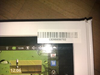

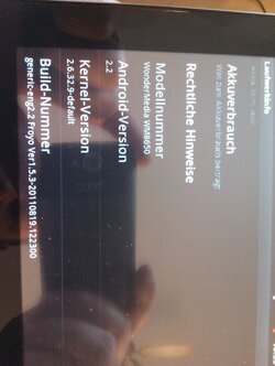

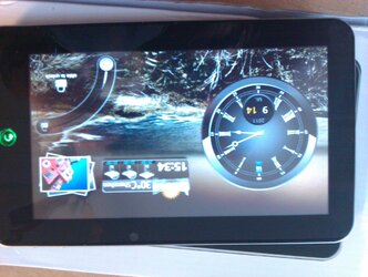

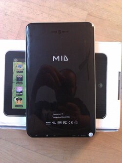

Hi guys.
Since today i have two MID 7" tablets based on the WM8650 and i will install the Android Market not these Chinese one that is built in :)
Can anyone say me what these tablets are so that i can look for a ROM or can anyone show me an way to use the Android Market.
Thx in advance
Oliver
