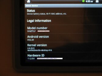

On the "About device" screen in the "Settings" application, on many infoTMIC tablet's the "Model number" is hard coded into the application or pulled from the build.prop thus, it is not a reliable identification of the device. However on some tablet's, once the device has been updated to 2.2 the initial boot screen lower right corner or the "About device" screen displays the "Hardware ID" which is obtained by running /proc/cmdline and extracting the digits returned for "hwver=". Using this information the latest infoTMIC updates can be manually downloaded.

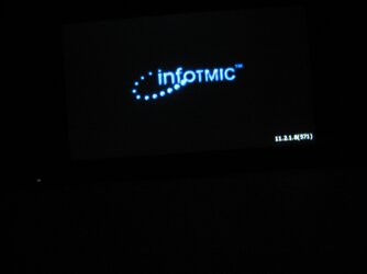

Notes: Some firmwares identify the Hardware ID "hwver" on the initial boot screen. Example: 0.7.3.1(658). The three digit number between the parentheses (###) is suspected to be the version of U0 - u-boot-nand.bin as it corresponds to the U-Boot file located within the InfoTM Update Wrap *.ius file.
Note: If the device has not been updated the "hwver" can be obtained manually by entering the string "cat /proc/cmdline" using either adb shell or in a Terminal Emulator application. More information regarding these methods can be found in Step 1: Hardware version identification either using adb or a Terminal Emulator application or Alternate Step 1) Terminal Emualtor method to determine "hwver".
Code:
C:\>adb shell cat /proc/cmdline
console=ttySAC3,115200 androidboot.mode=normal bmagic=0xeef07901 hwver=11.2.0.6

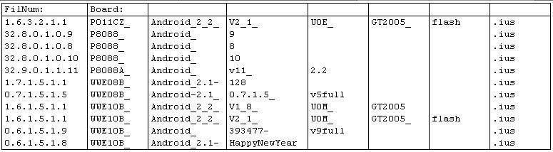

These are the update files identified to date -
Wrap Information:
Code:
[FONT=Courier New]Hardware ID InfoTM update wrap(*.ius)                 FileNum:         U0                                      U0        UBOOT     RD        LK        ADD_USER  ADD_AS
"hwver"                                               Firmware Version u-boot-nand.bin                                             RAMDISK   KERNEL    USER      SYSTEM
[/FONT][FONT=courier new][B]Infotmic AV-P8088A[/B]
32.9.0.1    P8088A_Android_v11_2.2.ius                32.9.0.1.1.11    2009.08-svn619 (Mar 11 2011 - 17:09:24) 258 KB    NA        165KB     2658 KB   NA        144860.5 KB[/FONT]

Unfortunately, the file naming does not seem to conform to a standard therefore making it difficult to determine new updates.
