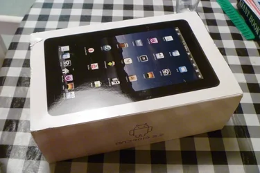

I recently won an Infotmic Android 2.2 pad from an arcade in the USA. I am not sure the model name or number, but it displays the Infotmic logo on the start up splash screen.
Unfortunately, it will not function at all. When it turn it on, the word ANDROID appears on the screen with a blinking cursor and it is not possible access the pad menu. I have pressed the "Menu" button many times, but nothing happens. I have also tried several times to press the "Reset" button, but it still does not operate.
Here are pictures of the packaging and the problem I am having:
Can anyone please help me? Is there any way to make this pad operate correctly?
Thank you very much!
