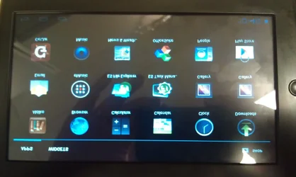

I'm having an issue with my Coby Kyros 7036. The screen will become mirrored and upside-down (See attached pics). I rooted it using vampirefo's method but I didn't backup the stock firmware. I did a factory wipe via power button and down volume but it's still doing it. If anyone can help, I would appreciate it.

I added some apps to it (Amazon App store, another app store that I can't remember the name of, Kindle, some games) but besides those and the root w/ gapps, that's all I've done. It started going totally wonky when I was using the Kindle app if that helps.

I need more info, trying to figure out what happened and not actually seeing it is almost impossible. What where you doing when mirror happened playing a game, eating taken a nap rebooting tablet? Right now I cant even guess what happened.

It's happening no matter what I'm doing with it. When I wiped it after this problem occurred, the menu with all the options were mirrored and upside down. When I turn off the tablet and turn it back on the Coby start up screen would have this issue. It was doing it worse then it is now but I could be in an app, in the settings menu, or doing nothing and it would happen. To push any of the buttons on screen requires tapping it opposite of were the icon is located.

Ok, that makes it more clear. You have a hardware problem, many things could have happened. Tablet got wet, dropped, or screen wire not plugged in fully or damaged.
Return the tablet, not a software problem, no way to fix this.

Thanks for the help vampirefo. Exchanging for a new one and I don't have to do it thru Colby support :)
