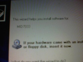

Peppermint Linux didn't see the tablet.
But, running the laptop that has Win XP Pro, it recognises the 7033 :cool:
2 drives show up, with nothing shown as being on them.
Edit - on another boot, by pressing the power button and the Vol down together, the PC sees just 1 drive, which it names 'VDfu'. In Device Manager it shows up as a Vimicro Super Disk at 512MB.
I've seen mention of FWDN USB drivers on the forum, but have been unable to find a download yet.

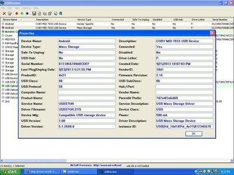

The USBDeview utility shows that the MID7033 connects, when the power is simply pressed on and where it bootloops with the Coby logo.
The tablet name doesn't come up when Vol + and Power are pressed, which gives me the VDfu disk of 512mb. Instead the Vimicro Super Disk comes up.
When the CobyADB root_restore MSDOS batch file is run, it won't connect unless the tablet is switched on by just pressing the power button. In which case, it says it's connected on Port 5037, but doesn't do anything.
