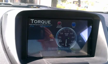

I'm in the process of purchasing a tablet (dont know which one yet) for my genesis coupe and have questions before doing so. Now, this tablet will be installed into my car so there will be NO WIFI available for this tablet. I want a tablet over a normal standalone GPS unit because with the tablet i am able to download apps to use for my vehicle.
