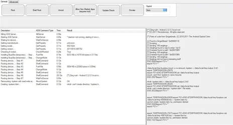

ive tried shell root first but i think its not rooted or anything see log.

its just says waiting for device but at the right corner it says "END:73643export PS1="
and then i tried to root still permission denied.

im having a hard time at this one.hehehe. :D

it says that my coby appears to be rooted but its not. cause when i try to use the link2sd it cant access the root,also other applications that needs root access i cant run it. how come it is rooted but it says it cant create directory. permission denied. :D, i noticed that the link youve posted has the same kernel and version as mine. its not fair.hahaha..why i cant root my coby.grrrr..hahaha..
im a bit noob here..how can i run adb?hahaha. i have installed the sdk package. but how can i run it. and how can i run those command i tried in "cmd" but i cant run it.hehe. i dont know if this is how to do it. i just run adb shell then run the command. see log
