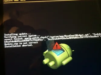

Ok - Purchased a MeMO Pad HD 7 on 1/3/2014 (my first Android device). Day 2, after having a bit of time to look around, and download a few apps from Google Play, I discover that there is a system software update available (from 4.2.1 to 4.2.2). So I tap the tab to download, then again when it finished downloading - Pad reboots, shows Android animated "Updating"... for a few seconds, then what I describe as a dead Android (laid down) with "Failed!".
After a few minutes, the pad would reboot back to where it had been before as if nothing ever happened. After multiple attempts, I contacted ASUS tech support (chat). Was given instructions and link - link was to download the correct software, instructions simply said to download the software on a computer, extract the contents to microSD, insert that card in the MeMO and wait for the notification... Well - nothing ever happened. I tried several times, even multiple "erase/factory resets". Nothing helped - device recognized the microSD card, I could move files, etc.. but the device never even attempted to install anything from the card.

I'm pretty sure #1 was indeed, a dud. I had the exact same problem when I used the wifi at my office (Pad #1). The file downloads just fine - it is just the update that fails to install. As the pic above shows - apparently there was a corrupt file that caused the update to not install (which mirrors what ASUS tech support said.). Even following the somewhat simple instructions for manually updating failed completely - but in that case - it was because the pad didn't recognize the update file at all - and didn't even attempt to install it.
