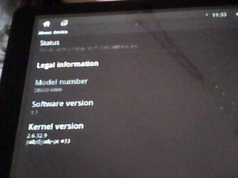

Done 1 of the tabs - although when restarting it doesnt look any different- where can I find out what android version is on it? Saw abt your comment re puffin browser on another thread thank you. (still showing as disgo)
When I know one is OK - I will attempt the next one!!!! Big thanks to you.
good, 1 all set, 1 to go; you can see the os in the settings, on the about device; yeah, puffin its the flash solution at the moment
Sent from my Sytabex7 Android Tablet
That was one of the first things I did - about Device - doesnt mention Android on it anywhere let alone what version!!!!! (unlike the picture posted in thread). My pic below:
weird, very weird; but is it working OK? if it is don't hesitate and do the upgrade on the other one also
