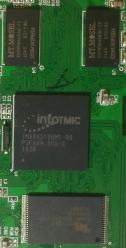

I tried to disassemble it and re-attach screen connectors. I tried to make hard reset - but it said that there is no backup image on device.

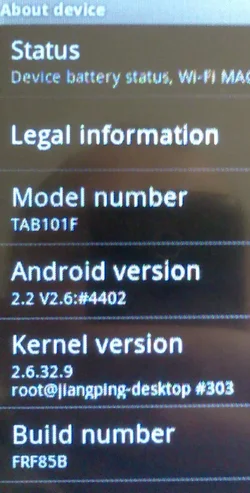

Here is some information about device:
console=ttySAC3, 115200 androidboot.mode=normal hwer=13.4.0.0 mtdparts=imapx200:2m@24m(ramdisk), 6m@26m(kernel), 128m@40m(resv), 192m@296m(system), 1134m@488m(userdata), 64m@1622m(cache), 2408m@1686m(local-disk),1m@4094(panic) androidboot.mode=normal
View attachment 5023View attachment 5024

During the splash screen see how the Hardware Id "hwver" 13.4.0.0 is followed by the "()". That typically contains the U0 "u-boot-nand.bin" 3-digit version code.
The missing backup system image "zSYS.img" can be burned with IUW.exe in Expert mode to restore this functionality.
Have you pulled down the latest firmware from EKEN Support Tablet PC,Car Video Recorder, and attempted to restore?
UPDATE: I see that in their firmware archive M013F.rar\M013F\android\ they did not include the backup system image SYSBACK also know as ADR_AS in IUW.exe or zSYS,img.
You could attempt to pack the provided system.img into an archive for burning but this requires some research, skills, and effort but a process exists to add a uImage header.
