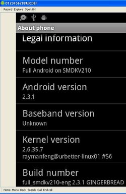

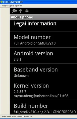

It appears to be a screen setting. After playing around with DroidExplorer I used the 'screen cast', which displays the output of the device on the pc. I am
able to navigate the device ie.unlock the screen etc,using the touch screen and buttons on the device itself, and everything I do is shown in screen cast. The tablet itself is still showing a white screen.
There must be a xorg.conf type setting for the android somewhere in the system files that I can change, just don't know where.
I used this file : Herotab_C8_0419_Gingerbread Rooted.zip
from the post: Unbrick or update Coby Kyros 7024 with gingerbread firmware...!!!!
Here is a screen shot from the screen cast:
