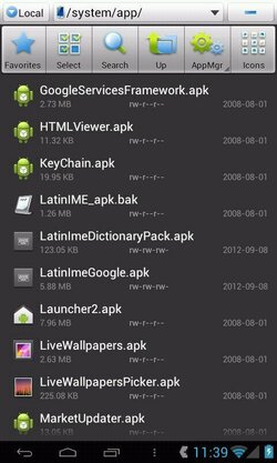

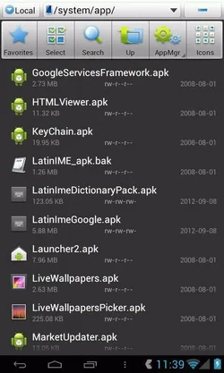

Those were 2 new files for me, so they did not replace any existing files: $uploadfromtaptalk1347130117434.jpg
I am using vampires mobiz rom on a 7042, and I installed latest gapps , LatinImeGoogle.apk was already present, dictionary packs were not.
