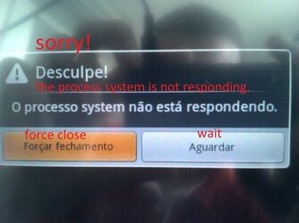

I bought a tablet zenithink G1-180 (256Mb) and it happens that the nap Friday night was using normal, and on Saturday when I connect it hangs on startup.

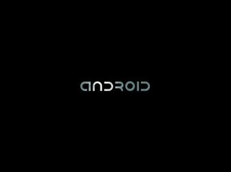

Well it boots is the symbol of Linux, and begins to load the gif android
but he is carrying a lot of time until you get the error message
I have not tried upgrading the android or anything the only thing I did was use androroot for the unit root
someone has seen this problem or know how to solve this problem?
