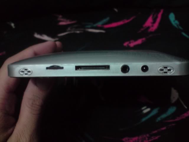

Hello everyone,
I'm new here so please bear with me.
Long story short: I bought an unidentified Pad from an online seller, he claims that this thing was an Apad. Turns out it wasn't. Reading PDF Files was taking forever. (Which was one of the main reasons I bought this thingy)
Please help me identify this Pad.
The package includes:
1 gray Pad
1 9V charger
1 gray adaptor with 2 USB ports and a LAN port
1 nondescript manual (without any model/brand description)
1 small stylus

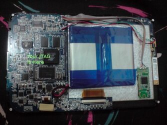

Hi Marty,
Yeah i F**ked mine up too I'm trying to get info on Reprogram SPI Flash thru JTAG
I'll let you know on progress, should be pretty soon.
(BTW JTAG port is right btw 'Your JTAG Port' and 'Is Here' on the photo i GIMP'd)...

Hello,
I'd like to know if you had any progress with JTAG. I have a J-Link Segger 20-pin cable (USB), and same problem and same tablet like yours, my doubt is where to soldier rTRef and Ground, cause J-Link cant recognize CPU or SWD. I soldered them to eeeprom (-) leg and +3.3v VPP leg without any resistors.
Thank your help, sorry my bad english.
