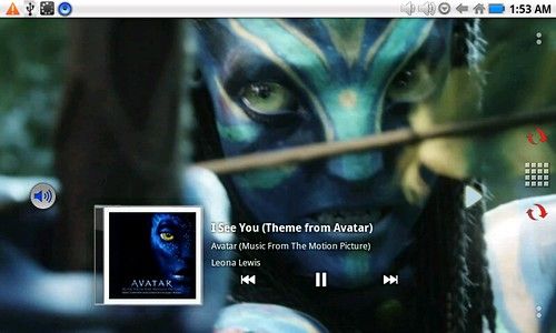

This is the Avatar Theme'd rom mod using the latest Lincsv3
