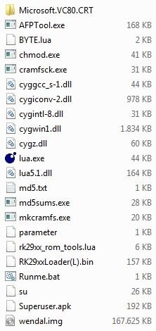

4. What you have till now should looks like this:

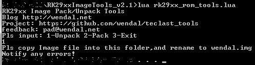

5. Now run the "Runme.bat", it comes up a command line window
6. Insert 1 and press Enter to unpack the firmware image file.
7. You're now asked again to copy the firmware image file to this folder and rename it to "wendal.img".
8. With the fact that we have already did it before we can go on directly pressing any key. The firmware image file will is getting unpacked now, just wait till it has finished.

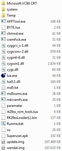

9. Your folder content should looks like this now:

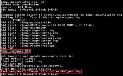

11. Go back to the command line window, insert 2 and press Enter.
12. That's all! If you see that making the firmware file is OK and you also read "Pack complete!! Target file --> wendal_new.img" everything went well and you again have a firmware image file (wendal_new.img) to flash on your device.
