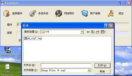

THE UPDATE METHOD IS HERE
I Prepare Works
Release the LiveSuit.rar and google-usb_driver.rar to your computer
II Updating
1. Open the programme LiveSuit.exe
A. Press the HOME Button on device and don't release, connect the tablet to computer via USB cable, now press the Power Button for 2~3 times (Always press the HOME button in this step)
B. If it’s the first time you reboot the device, your computer will be asked to install Drivers, Please install Drivers in this 2 folders “LiveSuit\UsbDriver” “google-usb_driver”
C. Choose “是” when it ask you
D. After the process go to 100%, Pull off the USB Cable, Press Power Button to start tablet and check it.
