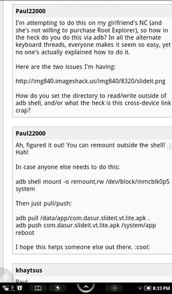

I found anotherway to do it on an old post: $11-03-29-1.png
Thank you Paul.
