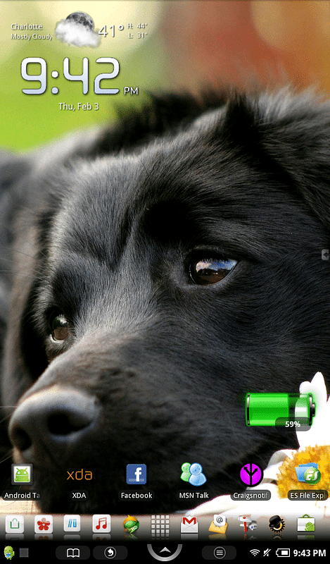

Very sorry to hear, I love dogs. No apology to me, I was clearly out of line when you two were just offering suggestions. Sometimes I play too much "mother hen" around here, when we have a nice self sufficient group (family) here in the Nook section and I shouldn't try to oversee and nitpick over every single post.
Here is my home screen to hopeful cheer you up a bit on this sad day.

It does...thank you.
