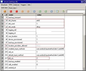

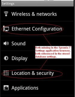

Also, with the common software the 7" devices think there is an Ethernet port where none really exists. The programmers have left eth0 turned on by default. Could this be an issue that could be resolved by turning off reference to eth0 device? In this firmware update, for another infoTM device, in the /system/app folder there is a EthernetSettings.apk application which can be installed on an updated 2.2 Sylvania device that will allow the Ethernet port to be turned off.
