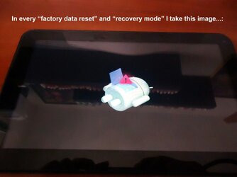

Recently i bought a 10" tablet with an Allwinner A10 processor and in try with a app (zroot something...) to root my storage to install some apps... In the first restart of the tablet, it shrink my primary internal storage to 26.41mb (the size of the pre-install apps)!!
Like this image:
I try to reset to factory settings, to reset, but always crash in start like it needs more space...

Just from the picture, I would guess /data isn't mounted, zroot shouldn't be used, no root tool should be used that messes with sdcard or modifying mount points.
Try to boot into recovery and factory reset.

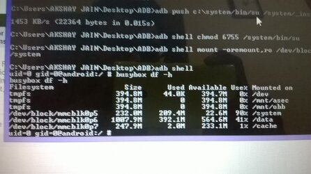

Post your df results.
adb shell
busybox df -h
My guess data isn't mounted on correct partition you would need to format your data partition.

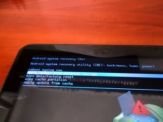

I try a lot of times to restore, but always take this image:
Also i try to wipe data & cache....
...but nothing happend... :(

adb shell
busybox df -h
About the above code... sorry, but is "Chinese" for me... I'm not a developer, i'm just a user and i don't understand what exactly means...
Wiping data and factory resets will not help you here, because they only clear the contents of the partitions, not re-size them. The code he is asking you to run would tell him about the partitions in the device. If you're not familiar with ADB (Android Debug Bridge), you should take the time to become familiar with it as most rooting methods require ADB to work.

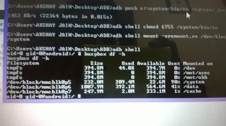

About the above code... here's the result...
in my tab firstly there is internal sd card known as internal memory of 4 gb from which around 2 or 2.5 gb is used for installing apps and ram etc. etc and 2nd is external sd card which is further mounted
now i have a problem in my device that the memory of installing apps and ram etc was as it is but rest internal memory which was before used for storage purpose is now become 0 bytes even i can't able to mount that storage by connecting my tab with computer.. in my computer it says please insert disk...
everywhere it says firstly mount sdcard means internal memory but i cant even open storage in my settings whenever i click on storage settings crashes...
I have HCL ME U1 tab... please help me.... i have successfully rooted it through adb commands given on ur forum
