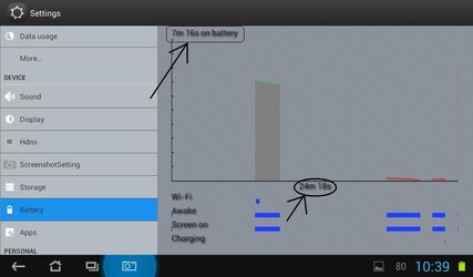

I took the screenshot below 1 minute after turning on the tablet (and after it being off for 11 hours and being on AC recharge for 3 hours before that).
Yet it shows I been on battery power for over 7 minutes 16 seconds, and what is the 24 minutes 18 seconds notation on the X axis of the graft denote?
