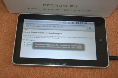

Just got Andorid 2.1 of ebay. As tablet was used previously I decided to restore to factory default. Unfortunately after this operation my tablet after Setup Wizard completely changed, I couldn't access internet and any settings as before restoring settings.
I did not received any CD with manual for this product so I can't do much a specially as not got any experience with Andorid OS. As on picture below U can see what massage I'm getting trying to access home screen button.
Please help, I even can not get any USB drivers for this unit.
It has an obviously outdated version of "LauncherPro" installed and set as the default launcher app. If you can get to Settings>Applications>Manage Applications
Wait for the list to load. "LauncherPro" should be on there. Select it. There should be a "Clear Defaults" button. Press it. Return to the Home Screen. It should now ask you whether you'd like to use LauncherPro, Home, or whatever other launchers may be installed. You could also just uninstall LauncherPro (since it has expired anyway) and it will have the same effect.
If you can't fix it on the tablet itself you're probably going to have to install the Android SDK and use ADB, but since you don't have experience with Android let's not cross that bridge until you have to. ;-)
Hi Thanks for reply unfortunately I'm not able to go any further that this screen. When I click home icon on menu bar its go black for few sec and loading browser with the same massage. I can not get to any settings.

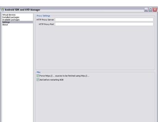

I have already installed Android SDK but I can't connect my device in to USB debugging mode as don't have right drivers and does from SDK not working.
But when I connect tablet in as mass storage I'm able to access files on one of 2 discs.
Also I'm not sure if my SDK source address would be correct as I just installed this application without any changes.

Finally I have manage to restore it.
What I did was:
1. use recovery option on start the system to restore do factory setting again
2. when asking to create google account I have filled in create/sing in opposition did but not been able to connect through APN as not got sim card as patently this tablet working also as phone but after that it sugested to connect to WiFi and after everything was easy to set.
