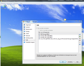

First off, you really have to use an XP SP3 in English, that's very important, but I see you've also tried that.
When using a virtual pc, the usb connection your host computer makes aren't automatically send through to your virtual machine. You can manually do this in the 'Devices' menu in the top of the virtual computer window, but that is too slow and you will still error at step 18. Instead, you have to let Virtualbox do this automatically. Go to Machine>Setting then go to the USB tab. You can add USB-filters by clicking the USB-plug with the green plus-sign on it. Add all relevant USB-connections. Please note that these change as the process reaches 75%. Add these new connections as well. The firmware update might not succeed at first try, but eventually it will if you have the right xp and all the connection filters.
Here is an image of the settings I used:
Of course these are the thing I experienced, so it might not be the exact solution for you. It is still very much worth trying though. Good luck and let me know if it works!

okay,i tested with an "y" usb cable under win xp english in virtual box.
2 connection first failed at 16% ,second success at 100%
yaisse she' s alive but in chinese :eek:
thanks to you both men ;)
