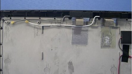

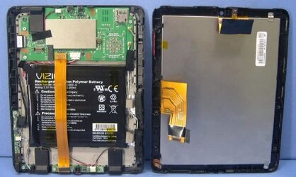

Looks like they used glue along many tabs on the edges. Maybe these pictures will help.

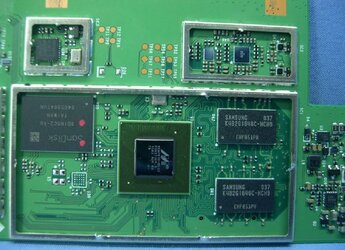

Question, since you have opened yours. Is the location next to the micro-sd card for the internal memory? Is the internal memory also a micro-sd card. It is on the pandigital white 7" and I've removed the internal memory and replaced it with a larger internal card.
Actually mine is still intact - I just stumbled upon some great photos of the inside that were used for FCC certification. The spot next to the micro-sd was probably going to be used for a sim card that has since been scrapped. I believe the picture below shows the processor and the internal memory card. Maybe someone can look up the SanDisk chip and verify. I hope this helps!
