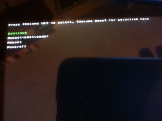

after upgraded the rom to mcl0201 (from an older rom of mcl) ... i now need to upgrade the cwm from v6.0.1.4 to v6.0.1.9c.
i'm on bootloader mode and have this menu:
i chosen in "continue", but it brings to reboot the tablet to the regular boot.
i tryd also with usb cable connected from the beginning and also connect it after i was in bootloader.
what am i doing wrong?
thank you.

Try reboot-bootloader and then flashing the cwm. Also, because MCL201 is Jelly Bean, you will want to flash the 6.0.1.9d version.

i'm in bootloader and the tablet is connected to the PC and this is what i was got after i chose in "reboot bootloader".

Don't reboot bootloader, just run fastboot commands.
O.K
so just to stay in that menu without choosing nothing and then start running the fastboot commands from the cmd?
Yes, stay at the that menu and run fastboot.
