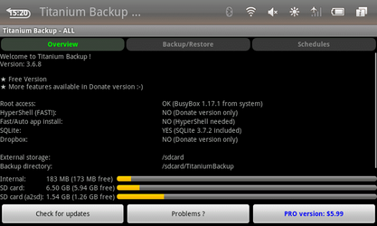

What i did was a fresh reload (just like when you bought it) > did the app2sd mod > then started installing my stuff. Everything installs to my internal cards partition. As you can see in the pic..... still have 173mb of the 183mb system, nothing installs there anymore. Still have 1.26gig free out of the 1.5gig partition for all my stuff i install.
