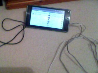

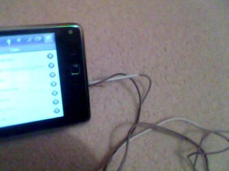

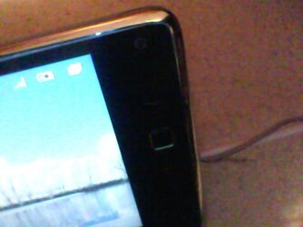

My charger was screwing up and I was trying to find a way to make a temporary fix so I thought, "Why not just stick a wire down the middle of a Chupa-Chup stick and wrap another one around the outside?"
So I went about this task.
First, I ate a Chupa-Chup. (Well duh.)
Then, I tried to see if it would fit into the charging port. Sadly, it was slightly too big, but the Chupa-Chup stick was no match for my scissors, which shaved it down to size.
I then chopped off the end which has the little hole in and that little bit of the Chupa-Chup that always gets stuck in the stick.
I stuck the positive side of my wire in the middle of the stick and I took four or five strands of the negative wire and wrapped it round the outside. I then eased it into the charging port and, hey presto, the charging icon appears!
It is currently charging my tablet and I will upload some pictures of it charging it within the next hour or so.
thek135
Apr 19, 2011
38
Here are some pictures of the charger in action, sorry for my crappy camera, hope you can see the charging icon:
I'm using a repurposed PSP charger which I mentioned in a different thread: Home made charger for Huawei S7 + other devices
In the past 20-30 mins, my tablet has gone from 55% to 69%, so it IS charging.
Thoughts?
